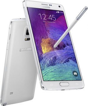

In that case, let's see if somebody has your exact model with MMS and data working and can confirm whether what you have in APN settings is correct.
That link shows note 4. My s4 for mms doesn't work either
