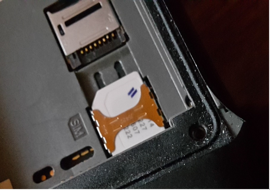

Wow, that link is seriously different looking than the one we've been working from, and confusing. It doesn't actually show the SIM inserted..
But saving dst11's picture and enlarging it, the SIM is the right size, and the right slot, it just needs to be rotated 180 degrees to match the engraving in the plastic of the phone. (That magnifying glass will be handy again to see the 'drawing' well.) (EDIT: Road Ranger's pic of the micro-SIM installed is great! no need for the magnifying glass.....)
The correct orientation is likely the alternate position you've already tried....
So , possibly a bad or damaged SIM card, or a bad SIM slot on the phone. There's a way to test it cheap, by installing a different AT&T-network SIM card. It does not need to be activated-- the phone should still 'read' it, indicate signal strength, etc. (An unactivated SIM may prompt you to activate it-- just ignore it, but it's handy because that definitely tells you it's being read.)

Those are some fairly deep grooves on the sim face. Maybe cutting a small piece of electrical tape to size and sticking on to the grooved surface might make a difference. Also, after installation try rebooting (Completely shutting down and restarting)two or three times and see if the no sim message disappears.

There should be enough space with a thin piece of tape on the top of the sim card.
