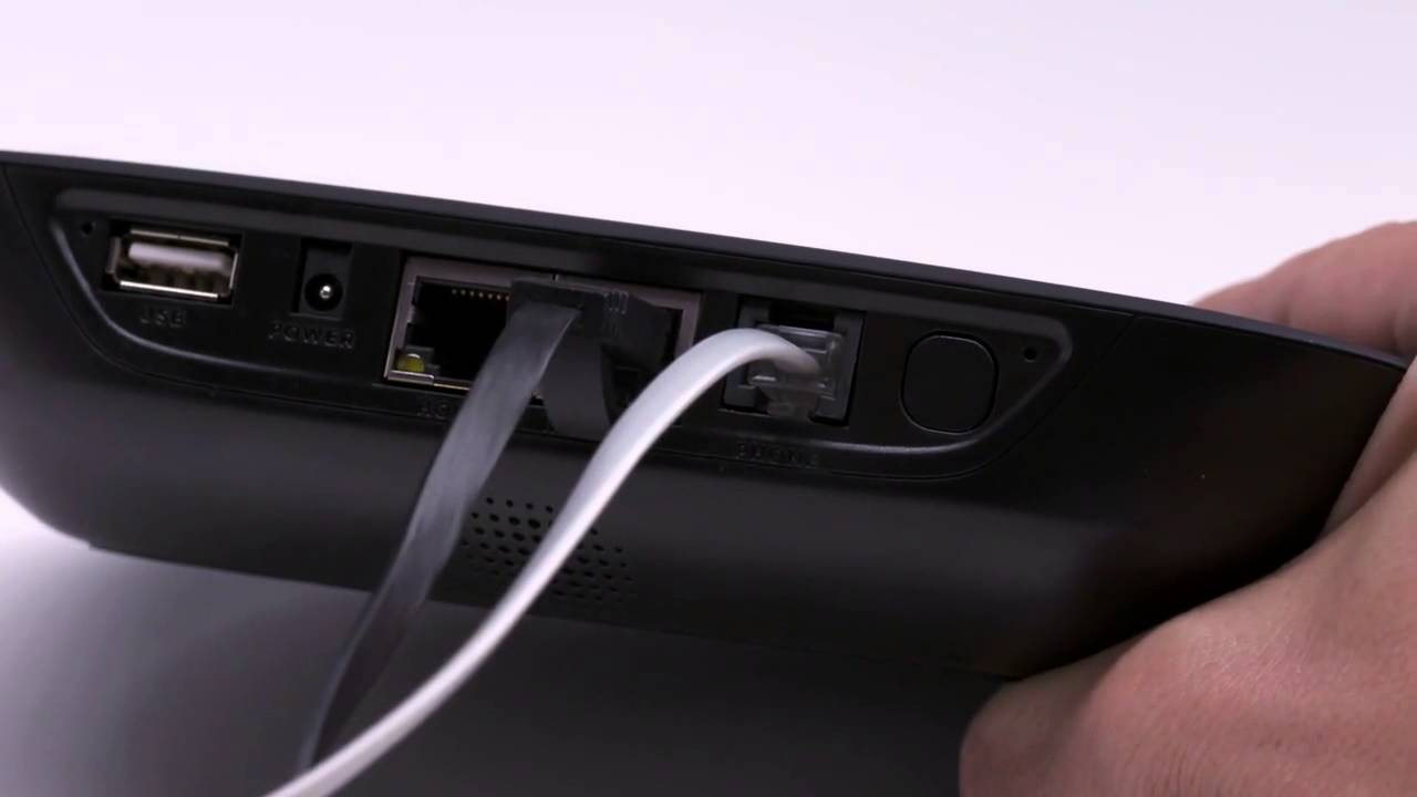

This all starts with the apparent EOL for Circlenet, which we used for keeping our faithful Obi110 online with GV.
After looking at the options - and mostly for the sake of simplicity - I settled upon getting a used Ooma Telo from someone at fleabay for a much better price than any new one could be found at.
It arrived & was activated via their phone folks - plugged in correctly - cycled through a bunch of colour changes for its light - and then just shut itself off.
(Wasn't even possible to reach into its own mini-server via browser to do a factory reset - zero response.)

Checked everything until finally looking at the wall-wart which had come with the used Ooma - 5V (check), 400ma...huh ??
The Ooma boxes require 5V 3A - which the new one came with, whereas I'd left the original wall wart plugged in as it is in a nasty spot to reach - so I changed that, and what happened ??
Boot up followed by solid 'blue' & working 100% for calls in & out.
Conclusions after all this absurdity:
1 - Minus the correct PSU the Ooma will start & -appear- to run, but isn't getting enough Ooomph to work 100%;
B - The weaker PSU could not power the wireless USB either;
3 - Our cable modem, a Motorola SB6121 isn't allowing...something through that Ooma needs, even though all other devices get along with it just fine.

I'm a little confused by your conclusions. Unless either you have two different home internet providers for some reason or you currently have your Oomae connected to your neighbor's wifi, doesn't the end result indicate that there's no issue with the cable modem and it was all the power supply the whole time?
I am no less confused actually by the same things...because:
The wireless adapter was a last ditch attempt to get it to connect - just because it was cheap enough to gamble upon - and as I tried to describe, the box's own little server indicated that it 100% had confirmed internet connectivity - but was NOT able to complete the VOIP connection with the Ooma servers.
It also refused the direct PC connection with its internal server with the 'outgoing' RJ45 connected - but connected fine with that page after that single cable was removed.
Then:
Giving it the directions to connect with our (separate) wifi router allowed the full VOIP connection to occur, somehow.
As to why that would make it through our cable modem vs. the 100% wired connection that would not - I have no clue and agree that it is not logical - but that IS how it happened, and it was repeatable as long as the stronger PSU was used - as it baffled me & I re-tested it several times.
Using the stronger PSU with the wired-only connection did not work for their VOIP to connect, ever.
Since everything else here - including an Obi box & a SIP phone work fine, I must guess that using our separate wifi router somehow changes something and 'fools' the Ooma box, allowing it to connect...somehow.
Electronic voodoo, perhaps ?!?
The wired connection (apparently) worked in your neighbor's house though, right?
I doubt your SB6121 cable modem is causing the problem. It's more likely a cabling issue, hub/switch issue (I've seen strange things happen with "green" switches and older NICs), or router issue.
If you are interested in discussing/troubleshooting further, I would like to know more about your network setup.
