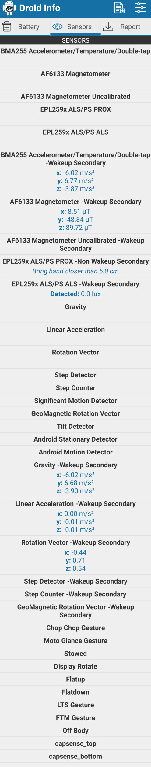

I did play around with the sensors a bit when I first got it using droid info.

Yes, it does track whether it is face up or face down.
I believe there is a flip to silence feature that can be enabled.
I tried to upload this to my last post but it wouldn't for some reason, now it worked.
When I first got an E6 I played around with the phone, casting this page and doing different stuff to it
