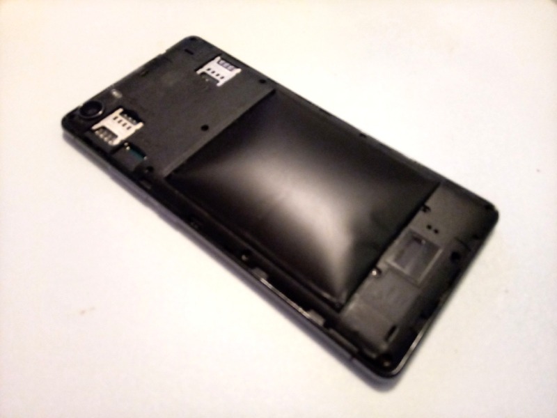

This phone has been my home internet for the past 3--1/2 years.
It's a Blu Life One X LTE with a non-removable battery and it's been plugged in continuously for all those years-- and the hotspot has been turned on for that entire time, as well.
It's performed flawlessly and still works fine, but the battery is so swollen that it popped off the back cover.
I've removed the non-removable battery and would love to put this back in service but, unfortunately, I can't find a replacement anywhere.
I'm going to be sad to say goodbye to Old Faithful.
How are your solder skills? :slight_smile:
A cheap compatible Li-Ion 2900 mAh battery shouldn't be too hard to google.
Not very good, but it might be worth trying. :slight_smile:
No need to solder:
https://www.aliexpress.com/i/4000453672052.html
This seems like a full replacement kit but since you have it open and battery removed, should be plug and play.
Wow, I'd be afraid of using that battery for sure. I like the solder idea. As long as it is similar capacity, it should be fine I would imagine. Then again, all I know is that I know nothing. Best do some research. Good luck finding something similar that you can place in there!

If I were going to solder I'd rather make a dummy battery since it's plugged in all the time.

Or you could get a donor that may not have had the use that you had and do a swap. Then you would have oem most likely, and much faster shipping.
https://www.ebay.com/itm/OEM-BLU-LIFE-ONE-X-L0070UU-REPLACEMENT-BLACK-WORKING-LCD-CRACKED-DIGITIZER-FRAME/143446791691?hash=item216618560b:g:PtkAAOSwnHZYk3pq

I know Chelle can handle almost anything.... but I wouldn't recommend soldering a Li-Ion, or any rechargeable battery unless one is pretty comfortable with soldering skills. It's not a beginner-level project, and they can explode if overheated in the process.
(Reference: I've soldered plenty of NiCad, and a few Li-Ion, packs in power tools, and I have pretty extensive soldering experience.)
Pop goes the battery.
This is what must of happen to the Galaxy 7 on airplanes
I've never ordered from AliExpress before-- never even thought to! But I did, tonight. That's the exact battery I was looking for.

My new battery arrived from China in less than 3 weeks!
I installed it, tonight, and my trusty Blu Life One X is like new, again!
Thanks for the help!
