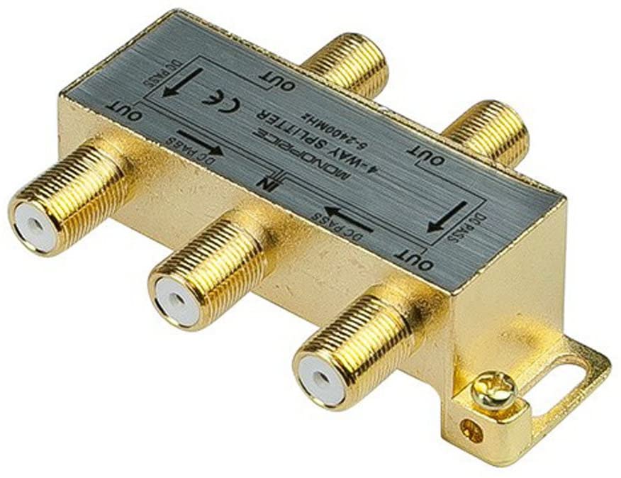

Most splitter on Amazon seem like junk. According to reviews
How is monoprice?

Have you tried reading the reviews on the monoprice? The reviews are posted to help curious prospective customers like you decide what to buy.

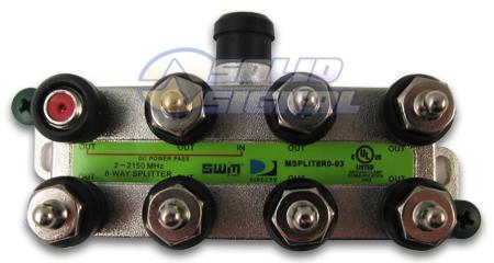

More info on splitters:
Wow-- nice link to an informative article about splitters! Solid Signal seems like a good source, and prices seem reasonable.
The only thing that surprises me is that some of the items don't seem to have spec sheets attached to the listings: which is kind of surprising from major manufacturers like Blonder Tongue.
re: gold plating. For most applications (short of active electronic components like edge-card connectors and integrated circuit sockets), this is simply marketing hype, and not a functional improvement. Nickel plating is standard on quality production connectors, and exists for most of the advantages you might be tempted to believe that gold-plating offers. Since effective gold-plating is expensive, most gold-plating is just for show, and actually performs worse than nickel.
Just from looking a little, it seems like the 7.5 dB insertion loss would be hard to do on a 4-way unit across the entire range: insertion loss seems to be specified in sections according to frequency, rather than consistent across the splitter range (as it would be with smaller bandwidth.)
I don't see any reviews for splitters on their site. Shame. You would have to cross search
You're right about the lack of reviews. I'll note however, that Solid Signal seems to only carry devices from the industry standard manufacturers, where there is little reason to cut corners or make questionable claims about specs.
Splitters are cheap devices, and it's a wonder to me that they work at all at such low cost-- but there are a lot of different options that may or may not be important for one's application. I'd guess that customer reviews would have to be taken with a fair grain of salt to try to vett whether the customer knew enough to buy the right device, or just counted the number of connectors and placed an order.
