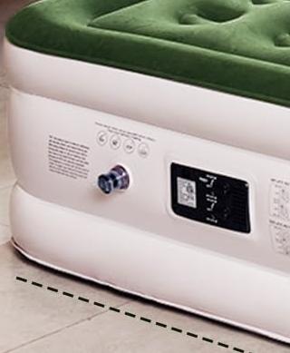

Finally I decided to indulge my curiosity & dismantled the built-in 'pump' in the 100% flat bed & THAT explains LOTS of things so far (I'm not done tearing into its innards yet...).
The 'pump' is just a tiny blower set up with a knob which both controls the inflate & deflate modes & the whole thing depends upon a single greased O-ring to hold the air captive...Oooopsy - an obvious point of failure.
I know this ain't a great pic, but ALL these 'new' 'pumps' look like this:
airbed
Please note the wonderfully pretty green flocked top of that bed.
The black rectangle is the 'pump' & a better pic would also reveal the little hatch with the cord inside as well as the rotary knob.
As part of my air bed future I'm getting a can of PVC cement & an external 120V inflator which will hopefully facilitate further testing & maybe even a lasting repair method.
My hope is that if I can totally seal off the opening left by extracting the crappy 'pump' - then use the manual filler neck instead it just may show up what is so poor about this design...or not - but worthy of a try IMO.

Having carefully examined the innards of the 'built-in pump' it is very obvious how these new airbeds work so poorly.
